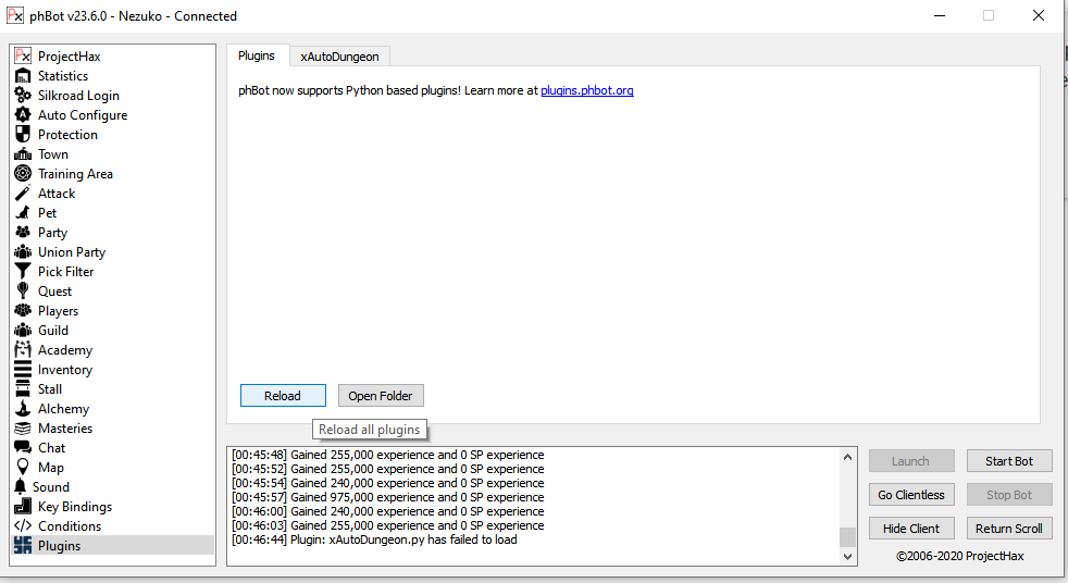

Is it normal for me to get an error when loading the plugin?
I started to get this problem today
You should only have one file for it in your Plugins folder.
I really tried it of all kinds I reinstalled them again and I just put a plugin to see if it worked and in the end it was still the same
@chinowumo did you update ur python correctly pls dobblecheck it
I have really checked it many times, uninstalled it and reinstalled it I did the python process manually and it does not work at all, but what I really wanted to check was if I am the one having a problem or is it with everyone, because this happens to me since I updated the phbot to v23.6.0 (previous v23.5.7)
That means you couldn’t successfully upgrade the python libs.
I already got the error, it was this little thing that was probably causing an error when loading the plugin, it seemed strange to me because the other plugin worked less this
If the same thing happens to someone, they just have to go to this folder and erase this ugly thing
