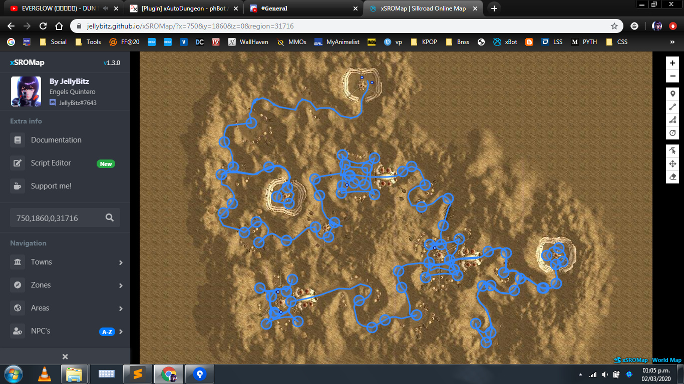

For people wondering how it looks like at xAutoDungeon v0.6.0 ( xSROMap ):
xAutoDungeon has no delay, it just starts/stop phbot on command. Delay is generated by phbot checking a lot stuffs.
v0.6.0 has updated command to be AttackArea,Radius?,CheckingSeconds?
Just use AttackArea if you are not on Bahdag dungeon.
