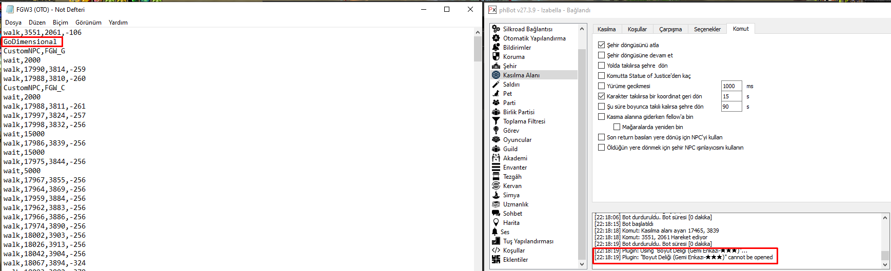

Hi, i’m playing in VTC Server, when using your file xAutoDungeon, the command GoDimensional make my phbot client disconnect. It shows: using "Dimensional Hole (…) then disconnect client.
Please help me to solve this, thank you very much

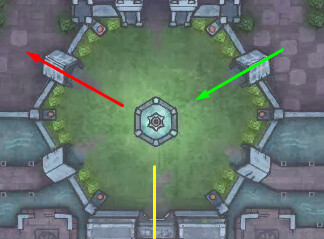

I am trying to use it in Hall of worship Jupiter FGW. The problem is:
The correct path is:
  1. Clears room goes red
  2. Clears dungeon comes back green
  3. Clears room again goes yelllow - Jupiter spawn
The problem is:
When bot is clearing the room for the second time it goes start/stop for AttackArea but when it starts walking again it picks coordinates from the start of the script and goes red path. How can I avoid this?
